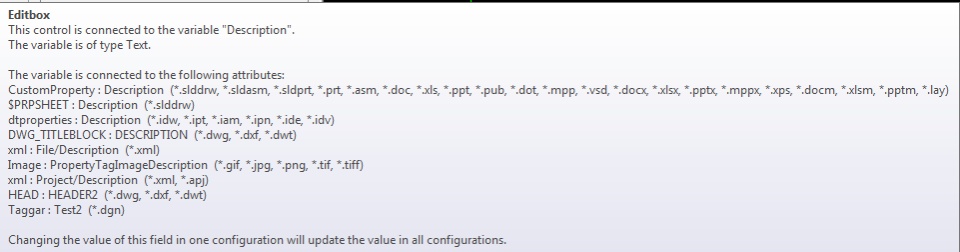

So after some research I finaly got ePDM to work with draftsight. Atleast the Check in/out works just fine. But now I have another problem. The data card will not sync between ePDM and Draftsight. I have tried to open an existing file from the vault and update the datacard, but with no luck. I have also tried to create a file outside the vault and insert it into the vault to see if prehaps it reads the data from the drawing, but again no luck.
These are some variabels that I see from ePDM. I have tried pretty much all the variables. In draftsight I use the define block attributes and then create a block, but prehaps this is the wrong way? Could anyone please do a quick "guide" on how this is done, I would be forever grateful!
