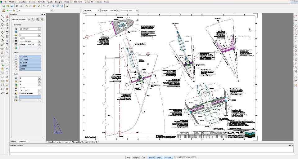

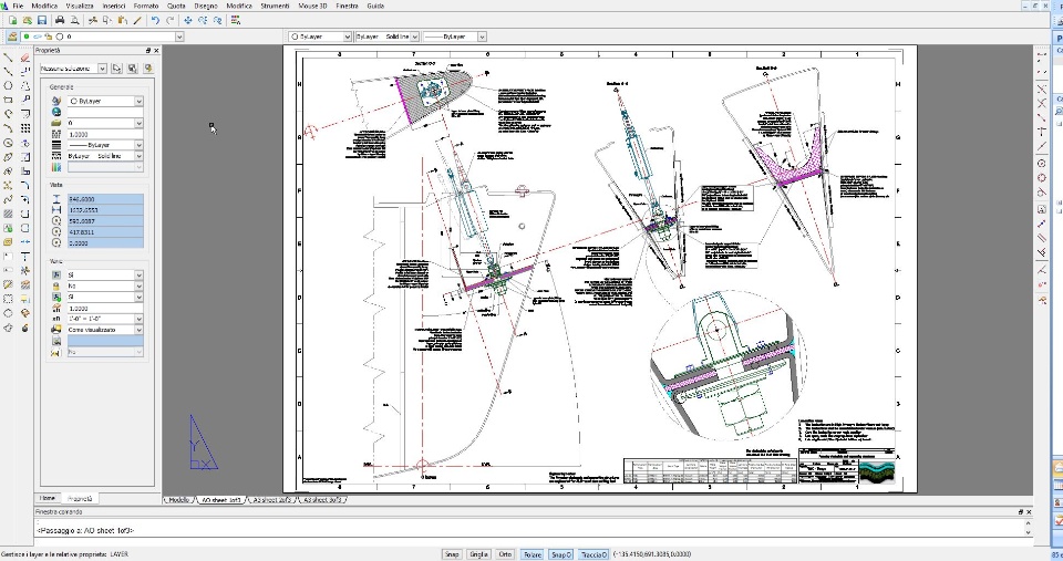

I add two image of the same file saved with ANNOALLVISIBLE set to 0 and to 1.
In Autocad both files show the same as all annotative objects are shown in correct window. In Draftsight  a lot of dimensions and annotations disappear.
