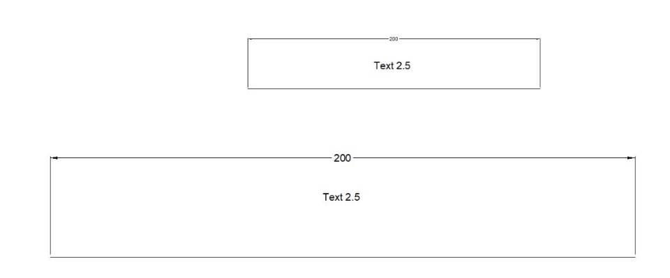

How do I make the Annotative text follow the scale I choose for my sheet,
So if I have 200mm long line and I want to show the line two times, in the scale 1:1 and 1:2
The text should be 2.5 and in the 1:1 it's correct but not for the 1:2 but still the dimension is annotative.
I know that I could use the dimensions straight from the sheet and not the model but if I works for me in AutoCad it should work in DraftSight, I thought.
https://www.youtube.com/watch?v=qzLycy7nboQ this video did not help, btw.
The screenshot shows how it is.
