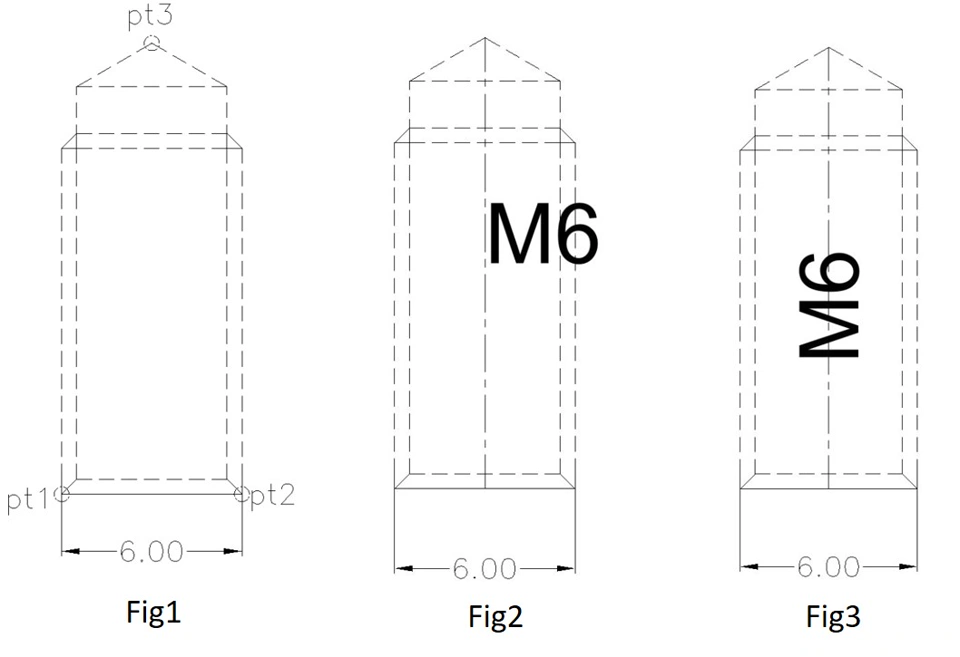

Good day everyone,
This is a code that lets me add center line between two points together with the text, the text input is a measurement between pt1 and pt2 with a prefix "M", this is almost perfect to what I need. What I need to improve is to place the text aligned with the center line (as seen in Fig3) however the text is place perpendicularly to the center line (as seen in Fig2), if the drawing is horizontal the text is place somewhere else. Fig1 is the original condition of the drawing generated from 3D. Is there a way I can change the code to make the text always aligned to the created center line similar to Fig3 and I also want to use the Text Style for the size of the text. Thank you in advance everyone.
