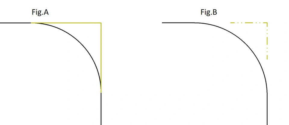

Good day everyone,

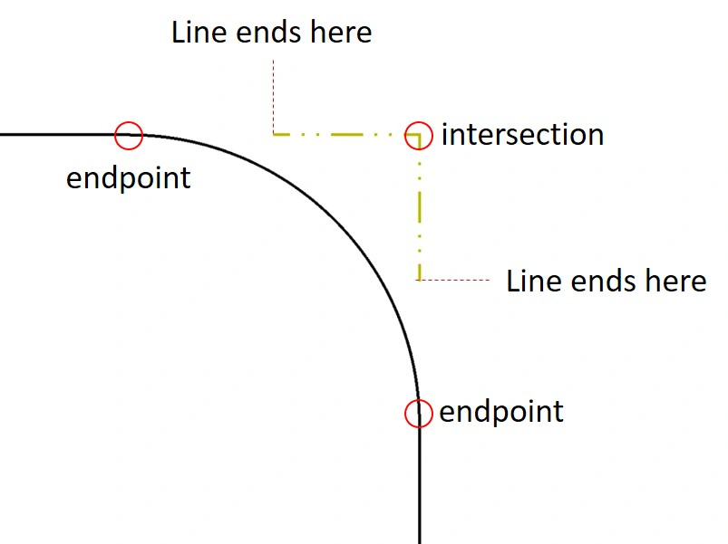

Below is a code that adds theoretical sharp on radius or fillet however the code below added the lines (yellow) directly touching the selected lines which can be seen in Fig.A. Is there a way that the created lines are detached on the selected lines preferably the distance is in the middle of the selected line nearest endpoint up to the intersection lines, last image shows what I'm trying to say. Is it possible to do it this way? Thank you in advance.
