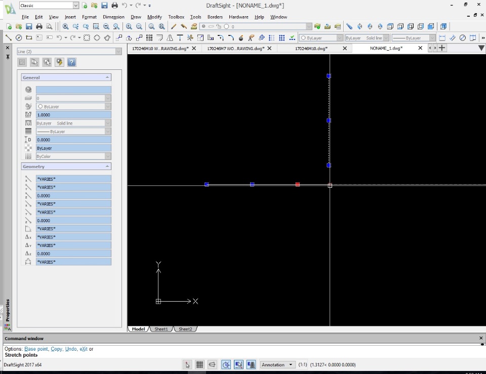

I am seeing an issue with Draftsight 2017  SP1 & SP2 that seems to involve e-snaps and apparent intersection.  I used to be able to highlight two non-intersecting lines which are perpendicular to one another and activate their respective e-grips.  Once activated I could drag one line up to an apparent intersection with the other line and a red X would indicate the spot at which the line was the correct length to properly intersect the other.  This no longer happens in these two versions.
I have all of my E-Snap  and E-track settings turned to "on" and Ortho activated as well.  The red X does appear as I drag the lines together. If I switch from Ortho to Polar, the function works properly except for the fact the lines might not form a right angle since Ortho is now turned off...
