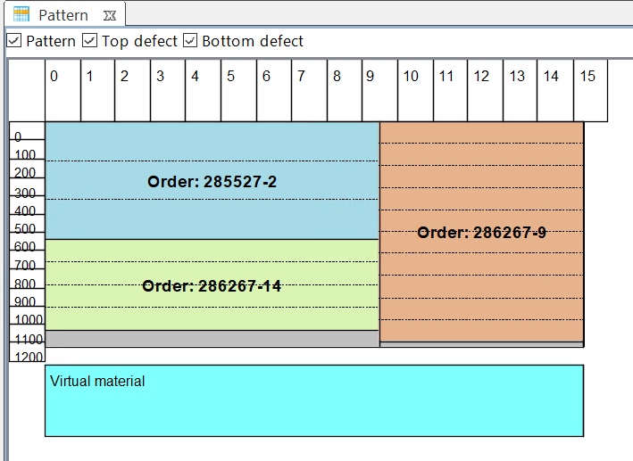

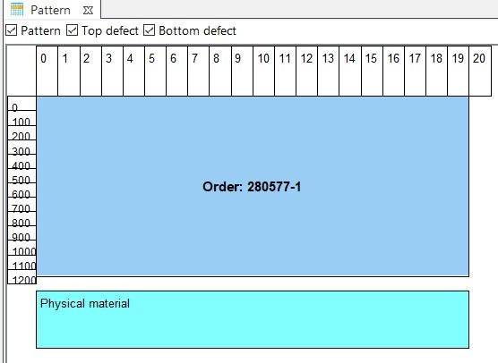

In such case, the OrderCombiner functionality allows to assign orders onto input materials, which can actually be semi-finished goods, as well as purchased hotrolled or coldrolled coils. The puzzle is to make optimum use of the input coil by combining with-wise orders next to each other, lengthwise after each other, or even combine it all. These combinations are showing as a pattern, a 2D visualization of the input material and how the orders are assigned on it. Below are two nice examples:
First pattern is rather simple, one order taking all of the material. The second is a rather complex pattern, multiple orders are combined width-wise and multiple are combined lengthwise. Additionally, at the bottom there’s some grey areas, which represent unassigned parts of the material.
I hope you can imagine that this type of puzzle might sometimes be straightforward, but can easily also become really complex, and hard for a human planner to find the best solution. Often we have also seen that if combining is required in a metals business, the planner makes these combinations once, some weeks in advance, but does not reconsider when new orders come into play.
