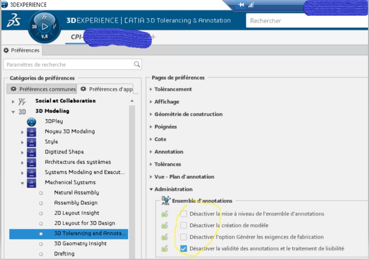

Hello Everyone,
I try to create Manufacturing Requirements from FTA (EBOM) in order to consume them in the machining operations of DELMIA Multi-axis machining app.
I work with 3DEXP R2021X On premise OTB .

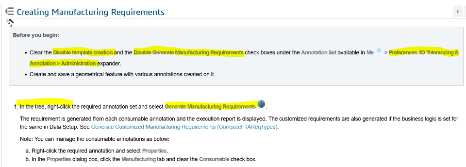

I 've configured preferences as indicated in the user doc but the requirement button does not appear !
Do you have any idea?
