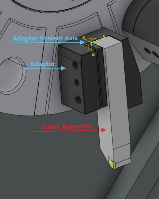

1. Lathe Assembly
I create Adaptor with Tool Mount Port (Adaptor System Axis - see attached picture) and Head Base Port (to place in Turret).
I place this Adaptor in Turret and Lathe Assembly in Adaptor. Lathe Assembly Base Mount Port attached to Adaptor Tool Mount Port.
How could I change gage of this assebmly? Should I create many system axes (tool mount ports in Adaptor)? Mayby we have some specific parameter or methodology to place this assembly in adaprot (or turret).

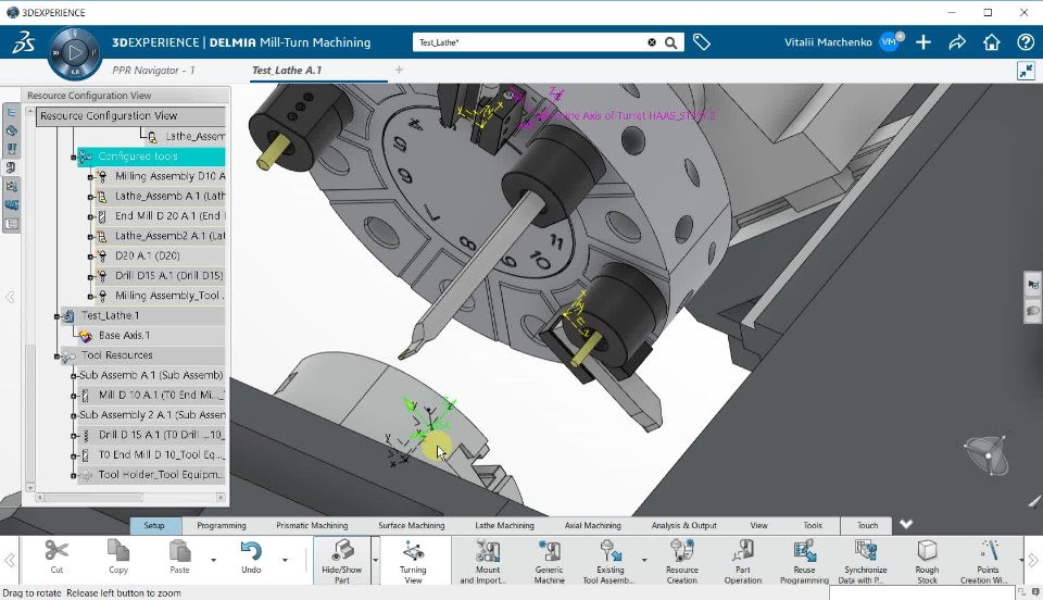

2. Mill Assembly
The same question with mill assembly.
In Configured Tools we have option Edit Local Parameters. But when I change Local Gage, then Tool Assembly Base Mount Port move from Turret. Seems Tool (not Assembly Base Mount Port!) Base Mount Port mount on Turren.
I attached video.
