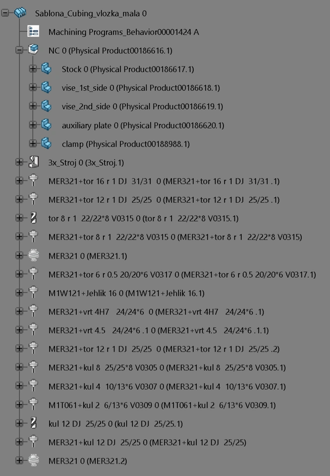

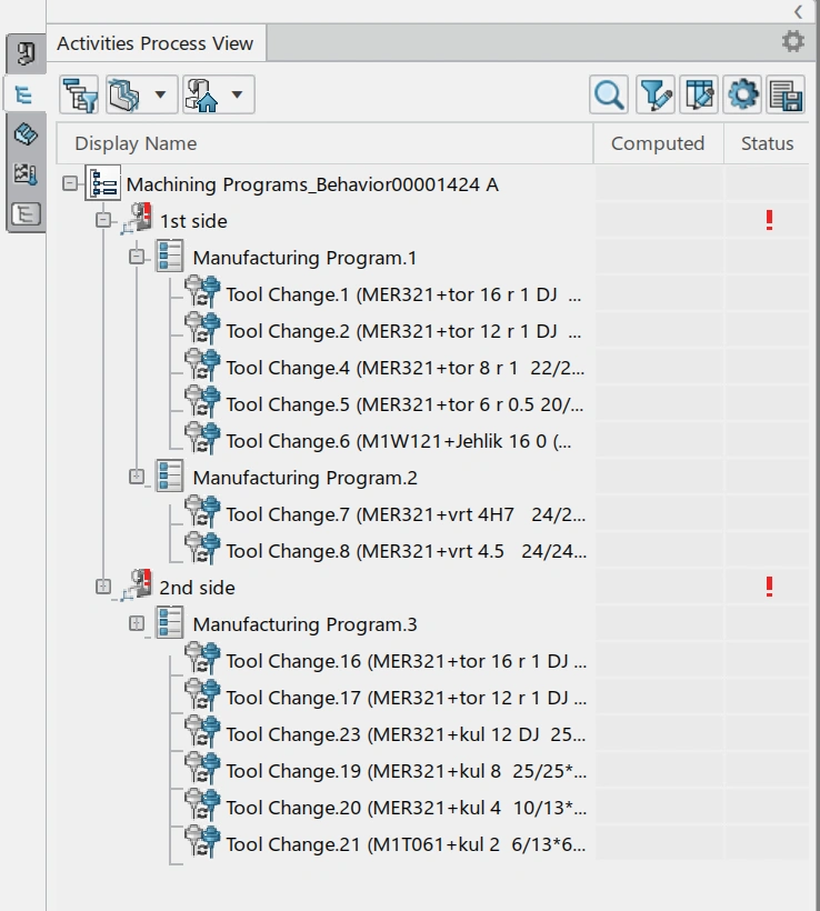

Hello,
I am working in Catia v6R2023 and I don't own a license ,,NC Knowledge Manager,,, . I would need some advice on how to create a nc cell template with a machine, 3d part set up for a blank and vises, tool changes  in manufacturing programs etc. that I can use for machining the similar types of parts. The pictures are an example of what I would like it to look like.
The only way I've found so far is to open the machined part in the milling machining module (the only machining module I have) and via machine configuration -> Load predefined configuration and insert the predefined cell. Only there I don't get the predefined Tool Change in Manufacturing Programs and the predefined 3D product with the 3Dparts are tied to the original assembly, so if I change anything in them it shows up in all machining cells where i used it.
Can anyone advise how to proceed to create something similar that will work as I need?
