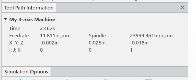

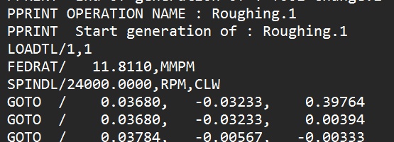

I went into preferences and changed all units that I could find to inches, and the simulation shows inches, but the aptsource file still shows millimeters, and so the resulting gcode is in millimeters. Any ideas what I need to change? Still watching tutorials,.. so maybe it will eventually come up.
