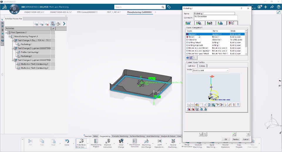

I have a new feature Reuse Programming with Feature Registration in R2020xFD01.
There is a problem in the process of using it.
So let me ask you two questions.
First, did I understand and proceed with the function properly?
(I have attached the video.)
If you say yes, why was the macro disabled when you moved the tab to the template?
And then redefine the macro, and then re-programming with feature re-reg
Why can't I choose a template when I use it?
If you say no, please tell me how to use the Reuse Programming with feature.
Please explain about it.
