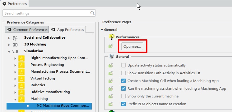

In order to optimize the computation times of the NC operations in DELMIA Machining, it is possible to activate the optimizations in the Preference pages.

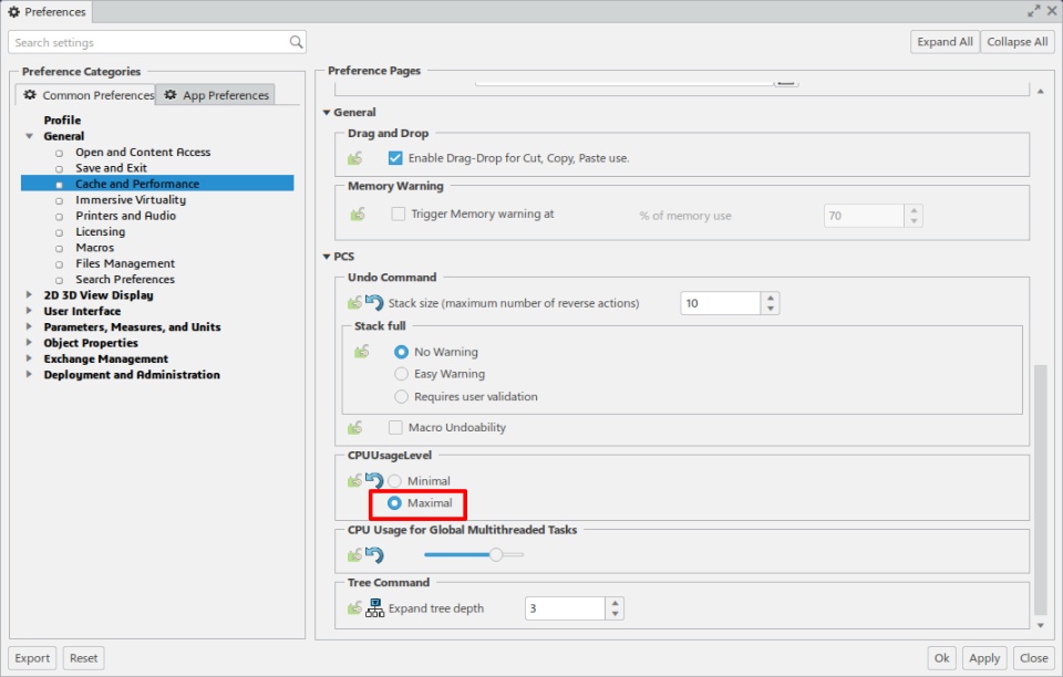

Another possibility is to set the "CPUUsageLevel" to maximum to enable multithreading.

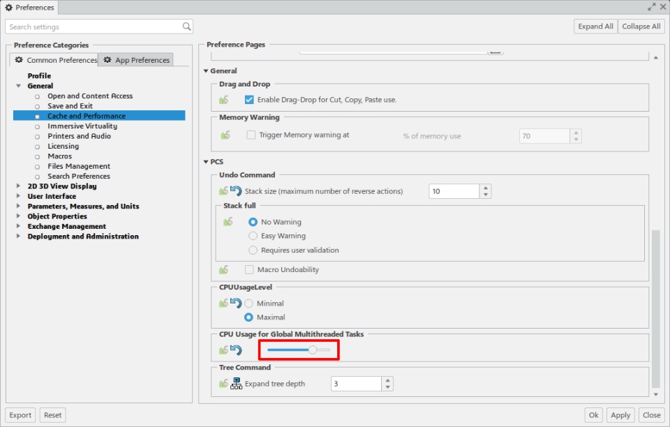

I found another switch in the Preferences: "CPU Usage for Global Multithreaded Tasks" with a default value of 75.
Does this slider also have an influence on the computation time and if so, to which value should this be set?
