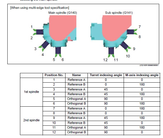

Hello all!
Is it possible to create some predefined position for turning tool in 3DX?
Thanks, Vitalii.
