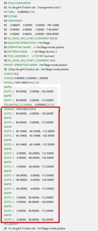

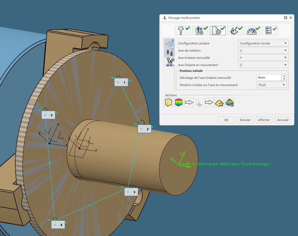

Hello, I am modifying a postprocessor for a 4-axis lathe (with Y axis) and when I use the rotating tools in polar mode, the coordinates of the toolpath are described in Cartesian mode in the Apt file. Is there a setting to obtain them in polar coordinates (C, X and Z) in the apt?
