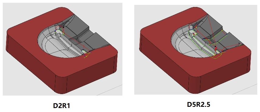

Dear Community:
I'm wondering how pencil milling operation define working area?
is it based on the Intermediate stock, that check all the current unmachining area?
or based on the tool parameter?
here i programming a pencil milling, use two different tool ,and the toolpath is different, even the bigger tool create wider machining area.
Thanks in advanced
Kim
