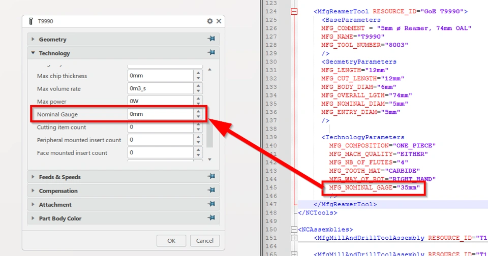

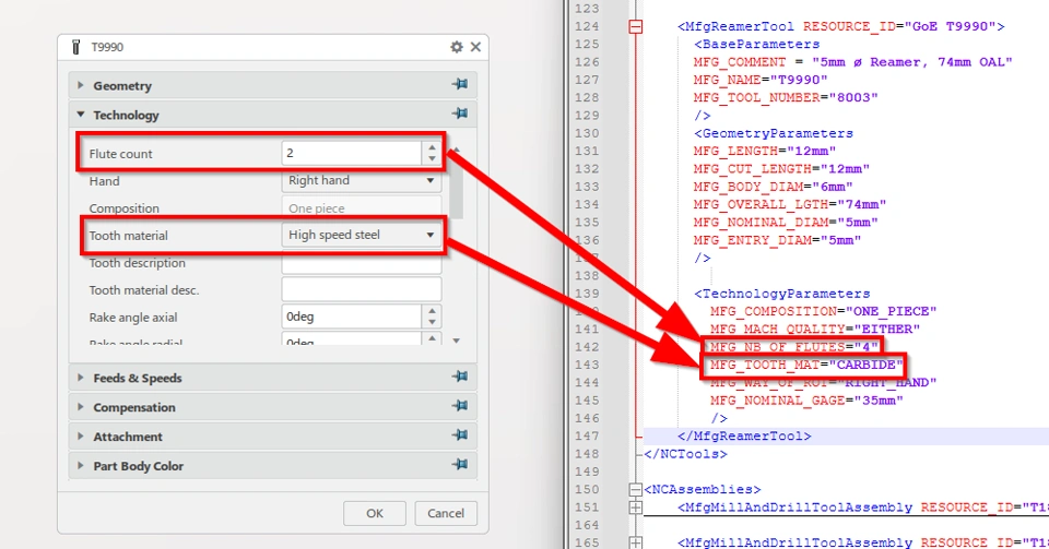

I am working with some XML tool imports, and only Reamers are giving me an issue. They do not seem to be reading their parameters under "TechnologyParameters". All my other cutting tools are importing correctly, and the report XML says that the status of the tool and assembly are "Created - OK". Am I missing something after staring at XML files for too long?

        MFG_NB_OF_FLUTES="4"
        MFG_TOOTH_MAT="CARBIDE"

        MFG_NOMINAL_GAGE="35mm"
