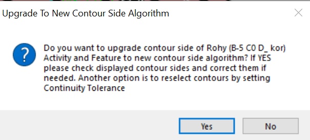

Notification "Upgrade To New Contour Side Algorithm"
In 3DEXPERIENCE, the "Upgrade To New Contour Side Algorithm" notification appears.

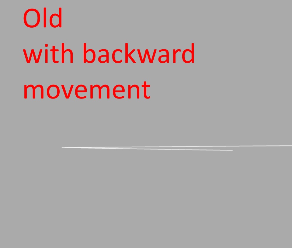

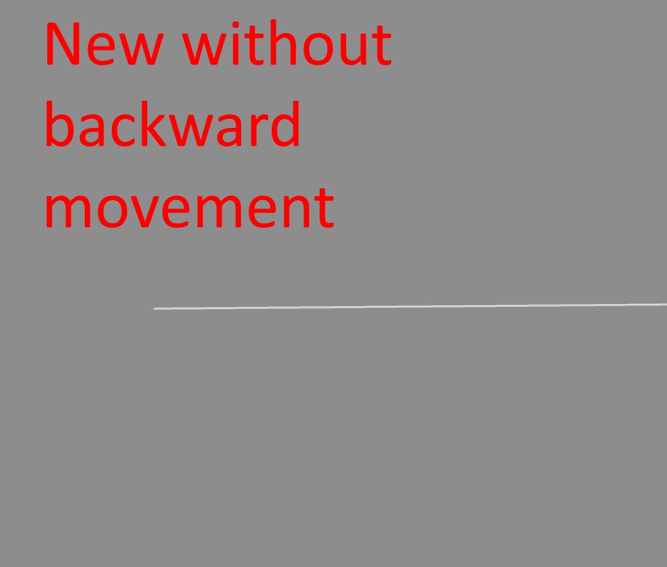

What does this new algorithm actually do? It is not only related to the contour side selection. The new algorithm also corrects the path of the 2D profile compensated tool.
