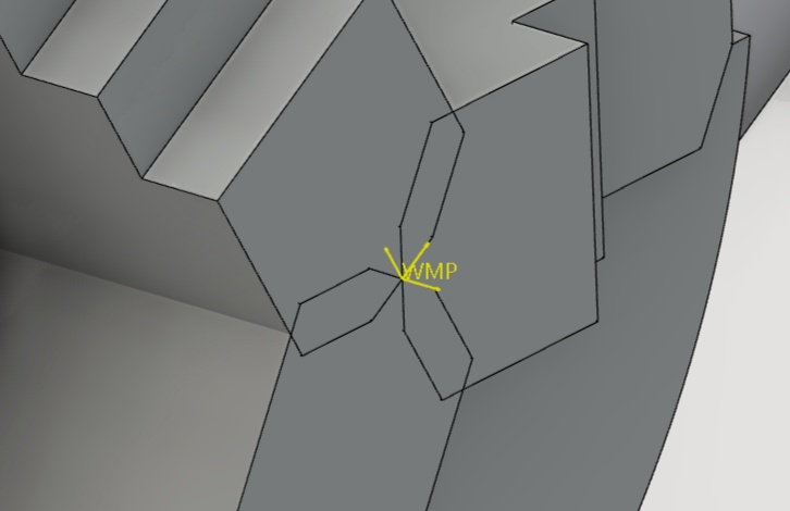

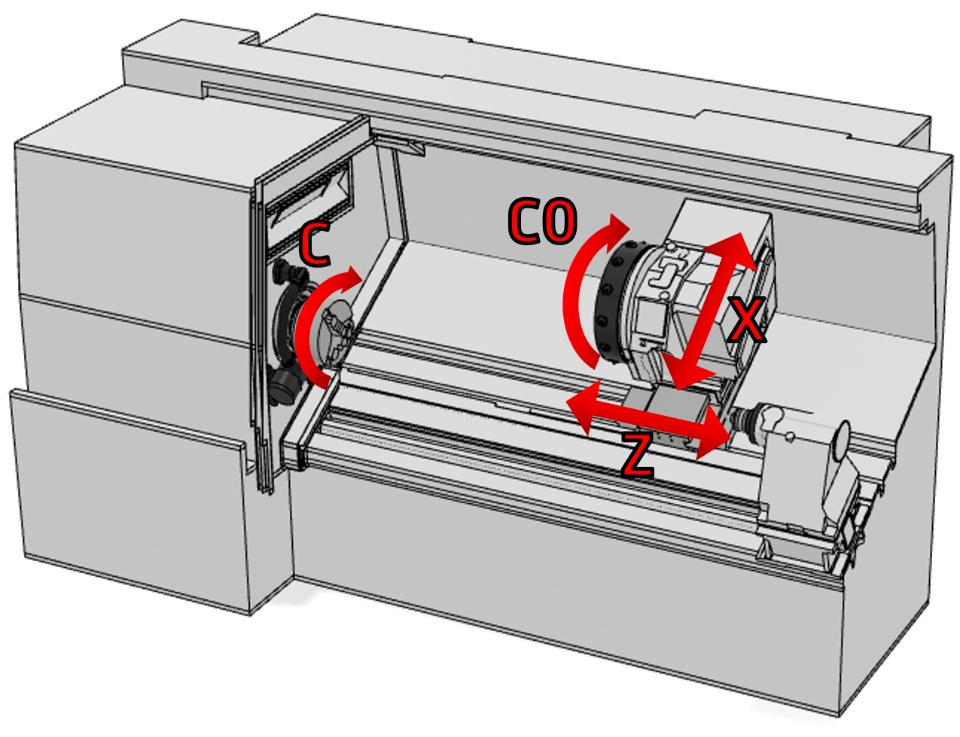

- in screenshot 1 you can see our machine's axis system -> x-axis is pointing backwards

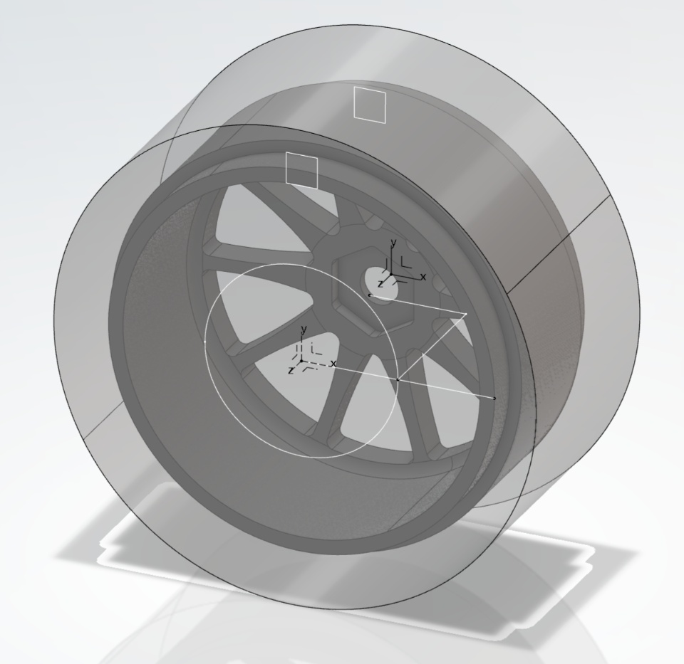

- the mount port is created exactly like that
- the Manufacturing Product has right handed coordinate systems, just like the machine

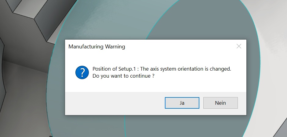

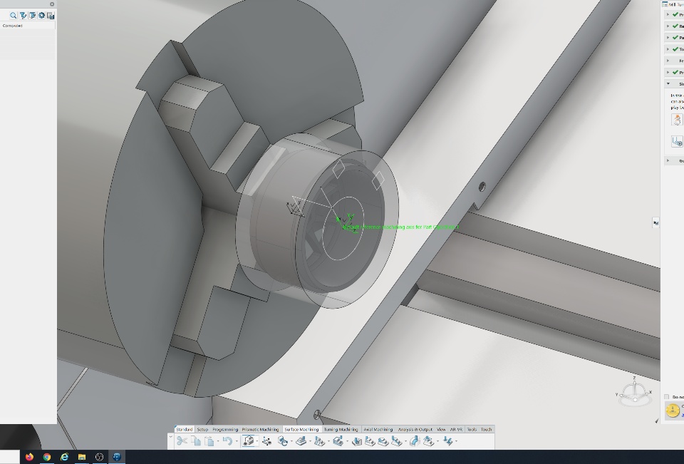

- when mounting the Product the NC coordinate system is automatically changed into a left handed coordinate system and y-axis is pointing backwards !!!!!
-> now the NC coordinate system does no longer fit the machine's axis...
Is there a way to change the NC coordinate system back to right handed, so we can simulate and manufacture the process?
