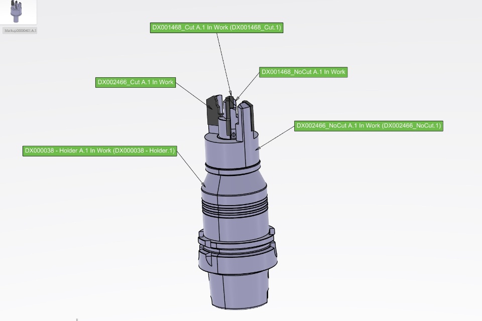

Good morning,
while I was building tool assemblies, I ran into a problem. The tool creation application, within CAM applications, allows the creation of assemblies with one or more tool holders and a single tool. In our company, more than 60% of the machining processes require one or more assemblies of several tools, as in the attached case. To be more specific, the same external tool in the example shown can have different "internal tools", or even the same one mounted with a different gage. Can you help me?
