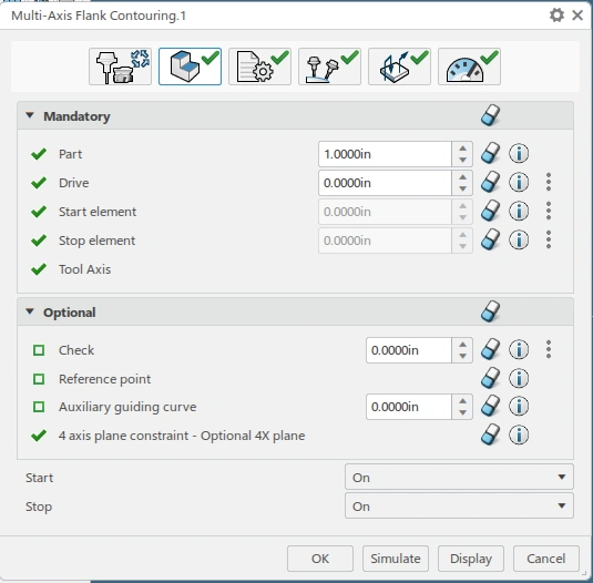

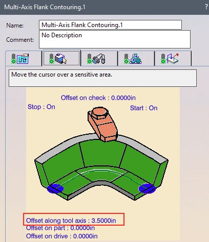

We have old V5 and 2021X manufacturing cells that utilized "Offset along tool axis" within the Multi-Axis Flank Contouring MOs. Now in the newer user interface we can no longer find this option. We're currently on 2022X FD02 but this option doesn't appear in the help files for newer releases either.
In the new interface this option seems to still be respected if it was set previously but we can't find it to edit it or use it in a new MO.
