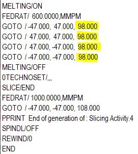

I noticed another change in the APT output since the last hotfix: compared to the previous output the Z level is lowered by one slicing step. That means that the first printed layer does not have an offset on the bed anymore and that the nozzle will collide with it. Furthermore the printed part will be one slicing step smaller than what I have designed.
Is there a way to change that setting back to the old one? Right now I am correcting the Z level whilst adding the slicing step onto the Z level. It works, but it does not feel like the intended way to do it.
1st screenshot: 1st layer, Z = 0 = clash
2nd screenshot: last layer, Z should be 100mm, but is lowered by the slicing step of 2mm
