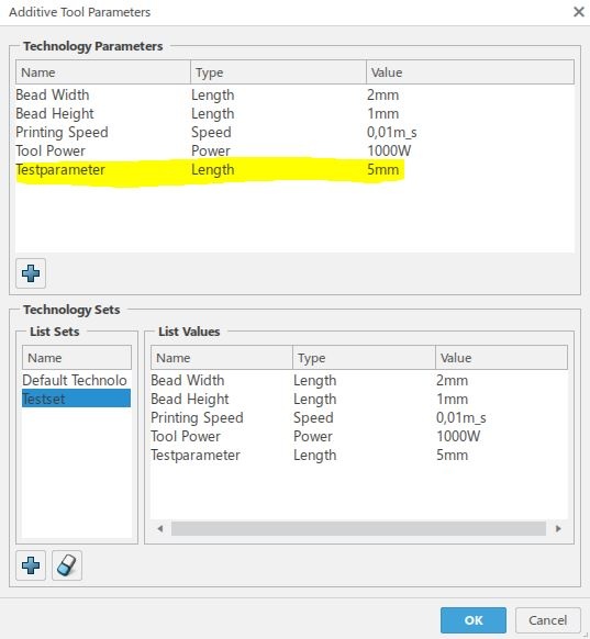

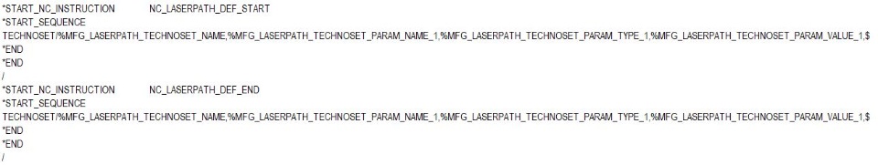

yet again I am having trouble transfering parameters into an APT file - to be more precise: parameters I set in a technological set of a deposition tool in the material deposition fabrication. Using the pptable to generate the output I need for calculation in the postprocessor worked pretty well, but ever since the last hotfix got released the output is simply missing. I am using the same pptable as I did before the hotfix and I even looked up wether there was a new one or new parameter names, but could not find any. Using the default pptable causes the same problem, even without modifying it.
Does anyone know if anything has been changed or how to fix that problem? Thank you in advance!

1st screenshot: technological set, 2nd screenshot: default pptable, 3rd screenshot: APT output (it does not even transfer the pptable's default parameters such as the technological set's name)
