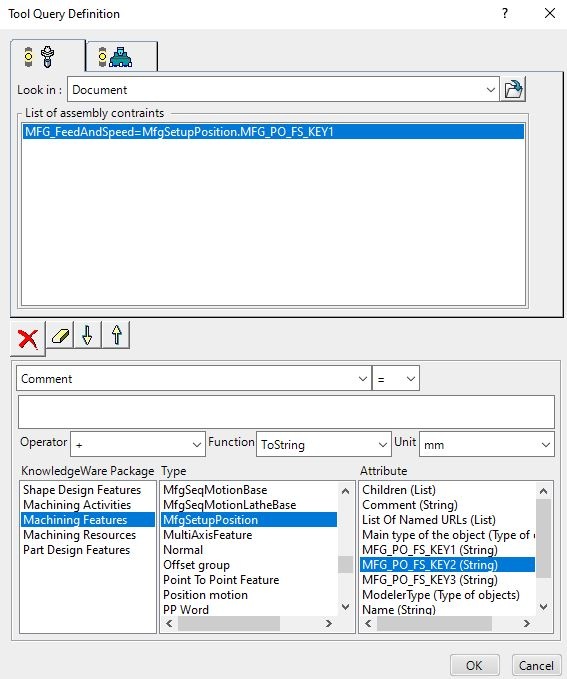

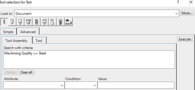

Hello,
In the tool query, the cutter or drill can be specified for a specific material, machining type and quality via "Feed and speed configuration". What is the syntax for the query, for e.g. Alu, Drill, no quality. And what is the syntax when the PO is included. I have tried it and this is the result.
