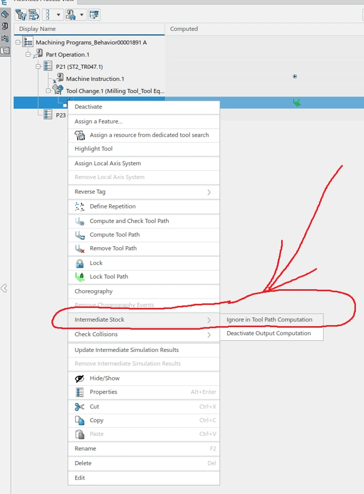

Good morning,
I have a question, when using intermediate stock, the tool path is conditioned, and looking at the output apt file, positions are added.
By deactivating in the various operations "intermediate stock > ignore in tool path computation" the apt file is correct.
Would it be possible to deactivate this option in the Preferences without having to do it for each individual operation?
