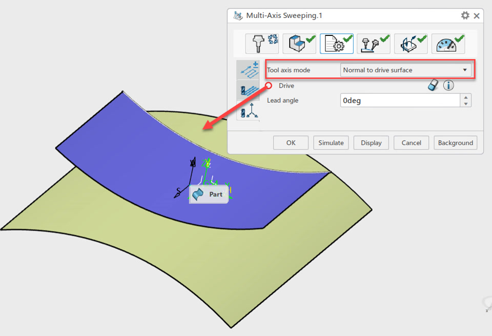

In "multi-axis sweeping" machining operation, when selecting the tool axis method "Normal to drive surface", the drive surface cannot be selected.
Hello,
In Multi-Axis Sweeping, the "Drive" cannot be selected.
I tested on 3de R2022x, R2023x, and R2024x, and the results were the same.
If importing V5's Process file, tool paths can be generated and simulated in 3de, but the selection of this "Drive" is still empty.
I want to know if this is a software bug or if there are other options available?
