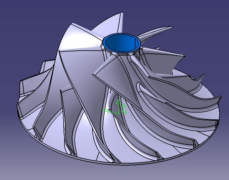

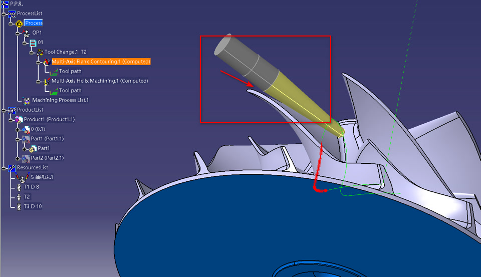

When the customer uses other CAM software to code the NC of the impeller, the tool rail generates only the bottom layer path, but the entire blade can be processed and finished without residue.
The NC code of the impeller compiled by CATIA V5 currently used failed to achieve the same effect. May I ask what command can generate a tool track along the bottom of the blade and finish the entire blade without leaving any residue
