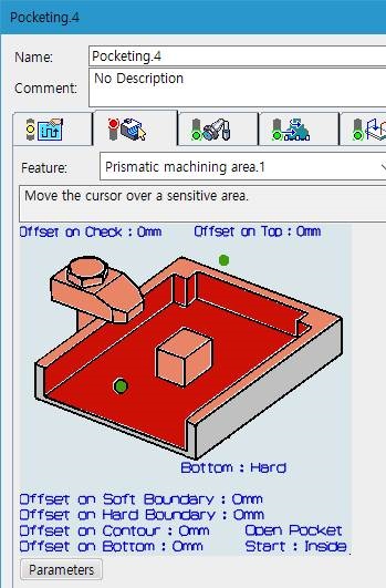

I want to use AddGeometry function in DELIMfgGeometryDefinition Class.
I am trying to add geometry to Manufacturing Operation(ex Pocketing, Profile Contouring, Isoparametric Machining etc).
(I used this in 3DEXPERIENCE DELMIA Multi-axis Machining Apps)
The source I used is as follows.
HRESULT hr=NULL;
DELIMfgGeometryDefinition_var GeomDefinition(_spOperation); // _spOperation = Manufacturing Operation
CATString usType = ""; // "PartBottom", "Checks", "GuidingElements" etc..
CATBaseUnknown_var spItem; // geometry item to add
CATIPLMProducts_var prod; // Product to which belongs the geometry to add
hr = GeomDefinition->AddGeometry("Checks",spItem,prod) // S_OK But Update Falied
hr = GeomDefinition->AddGeometry("StaringPoint",spItem1,prod) // S_OK and Update Succeeded
hr = GeomDefinition->AddGeometry("EndingPoint",spItem2,prod) // S_OK and Update Succeeded
It's working as well in some manufacturing operation like facing, spiral milling, Cavities roughing etc.
but it is not working in Pocketing.
In Case : StartingPoint, EndingPoint
AddGeometry returns S_OK value. and Update Succeeded
In Case : Checks, PartBottom, Drives
AddGeometry returns S_OK value. but Pocketing Manufacturing Operation not update.
how can I use this function well.. ?
I want to automatically add geometry values into Pocketing.
I need help. THX.
