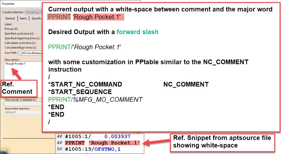

I would like to format MOs' comments with some options. As of now all we get PPRINT and a white-space after the PPRINT major word and then comment text string.
For example if I have comment inside the MO's description
'Rough Pocket.1'
It comes out in aptsource like this with a white-space after
PPRINT 'Rough Pocket.1'
It causes a problem in my post-processor
But it works out fine if it can be output like this
PPRINT/'Rough Pocket.1'
or like this
PPRINT/ 'Rough Pocket.1'
In other words if there are single quotes used around the comment then a white-space between PPRINT major word and the comment causes a problem.
I would like to know if we can set the format for the MOs' comments somewhere in the PPtable?
Thanks.
