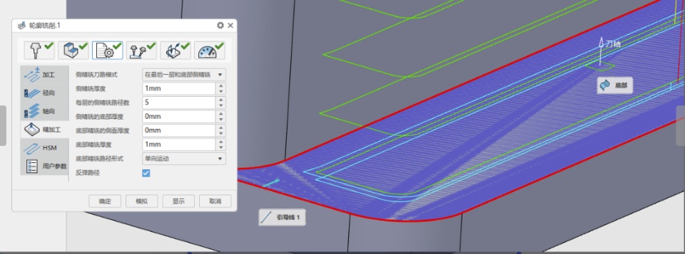

i have some questions with finishing programming in prismatic machining:
  1. the finish tool path sequence, when we set both the side finish and bottom finish, the sequence seems default to be bottom first then side, we cannot modify the sequence.
  2.  we cannot set the step distance for bottom finish tool path, it default to be same with roughing setup.
  3. the bottom finish tool path do not reach the side(remain side thickness); and the side finish tool path do not reach the very bottom (remain bottom thickness); it seems will leave stock in side or bottom side;
Thanks in advanced.
