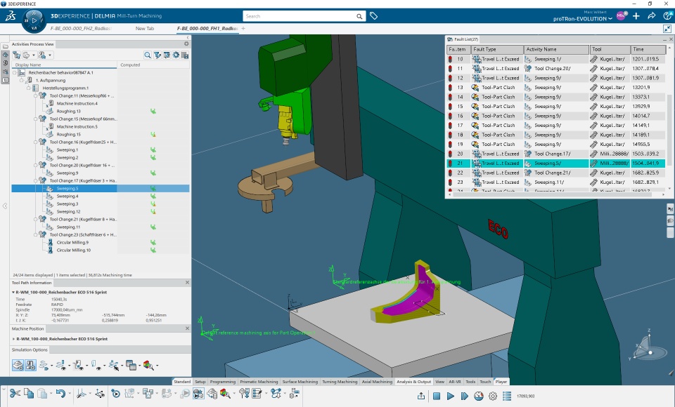

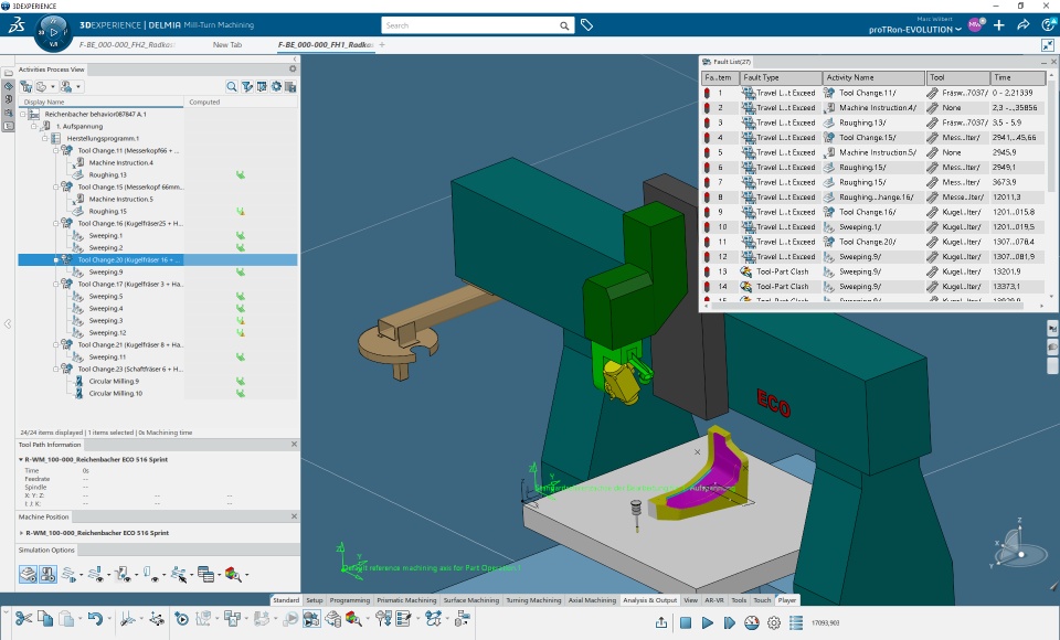

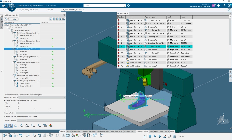

1) The travel limit is exceeded during each tool-change. The machine moves much higher than it should in the tool change routine. In addition, the milling cutter is suddenly in the middle of the component and no longer in the milling head.

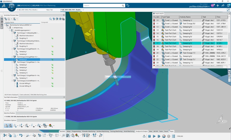

2) Furthermore, tool-part clashes occur with a penetration depth of 0.007 or a multiple thereof. The same error with the same value has also occurred in other processes for other milling machines. In most cases, the milling cutter is also perpendicular to the surface so that no collision can actually take place. Enclosed a few examples.
