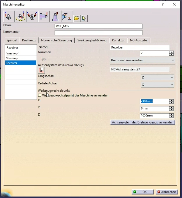

I want ot have the capability to change the Tool change position in the CAM Process. For example the WFL machine have a variable tool change position.
In v5, we were able to Edit that:

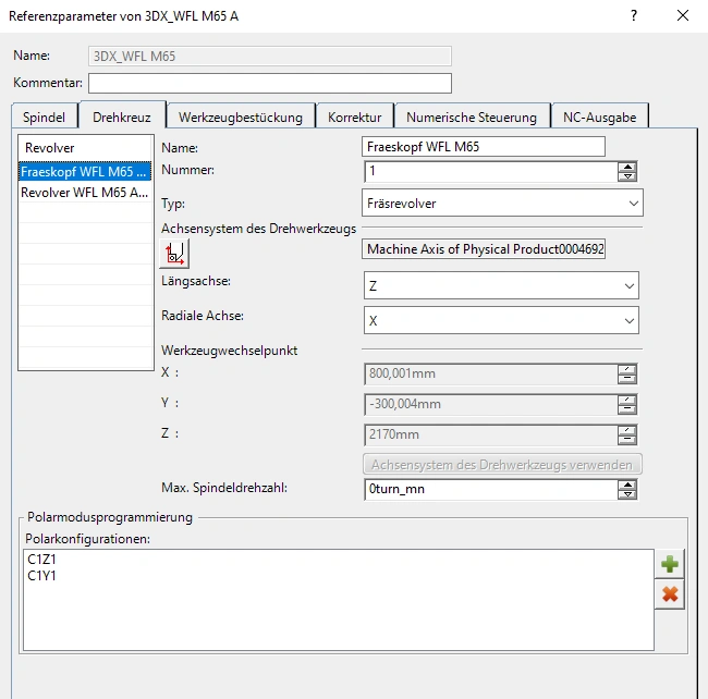

In 3DExperience, the values are Locked and I can not change them:
They are greyed out. Also, they do not appear in the Machine local parameters:
Is there a workaround here? Or can we add the option to edit the tool change position option in the local parameters?
