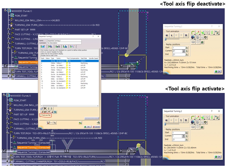

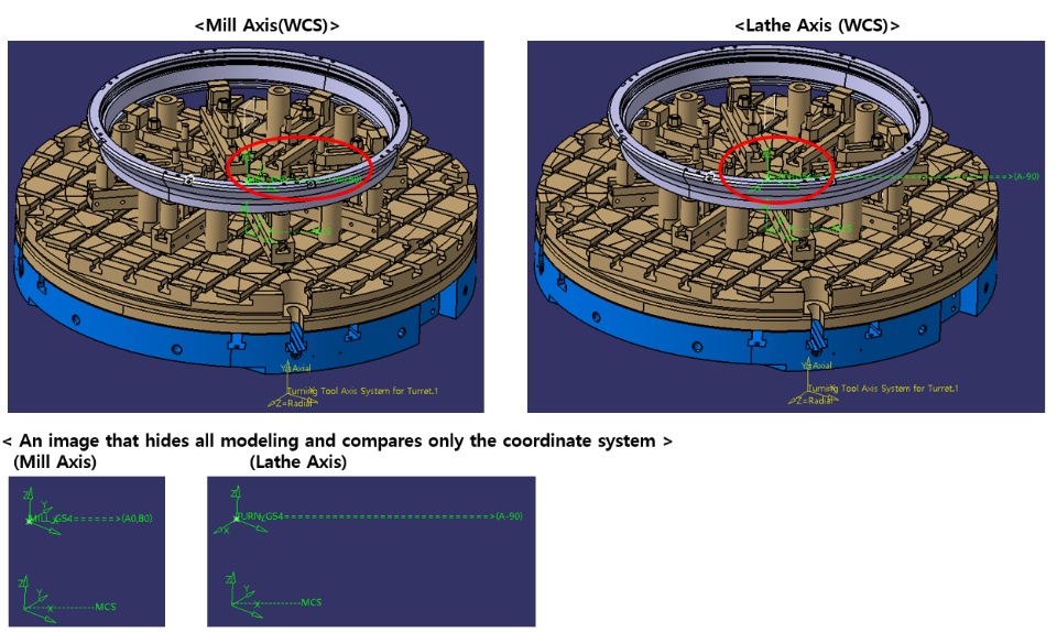

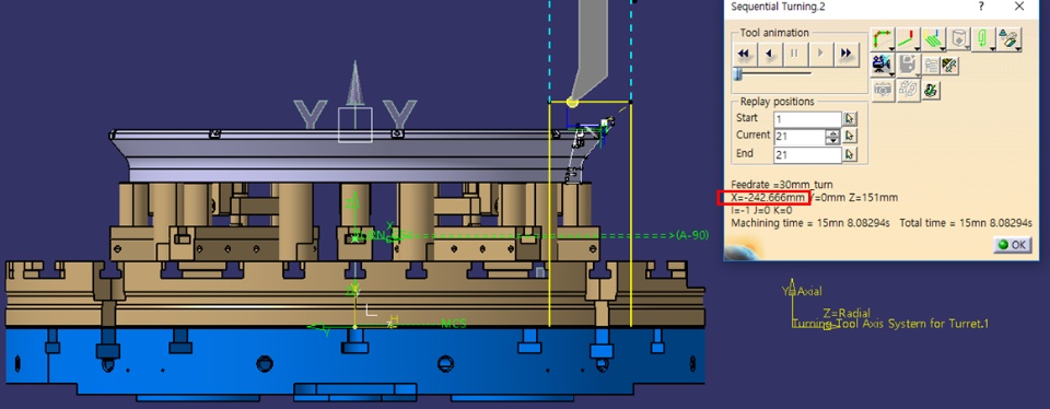

1. If a lathe tool path is created in the +X direction based on the XZ plane of the lathe coordinate system, it is output as a –X value. What setting should I change so that the X value is “+”?

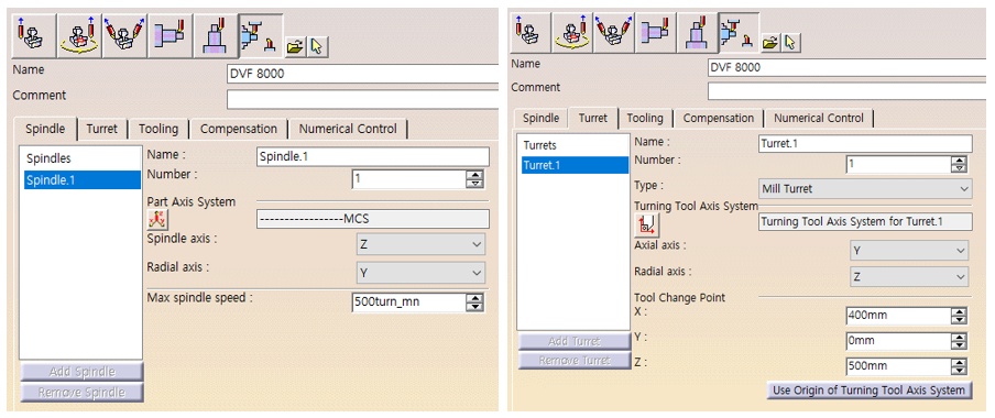

How can I set the spindle and turret of the machine editor so that the tool motion remains the same while changing the corresponding X value to “+”?
2. If the current tool axis reversal is activated, the tool is flipped up and down as shown in the image. What settings do I need to change the rotation to left/right?
