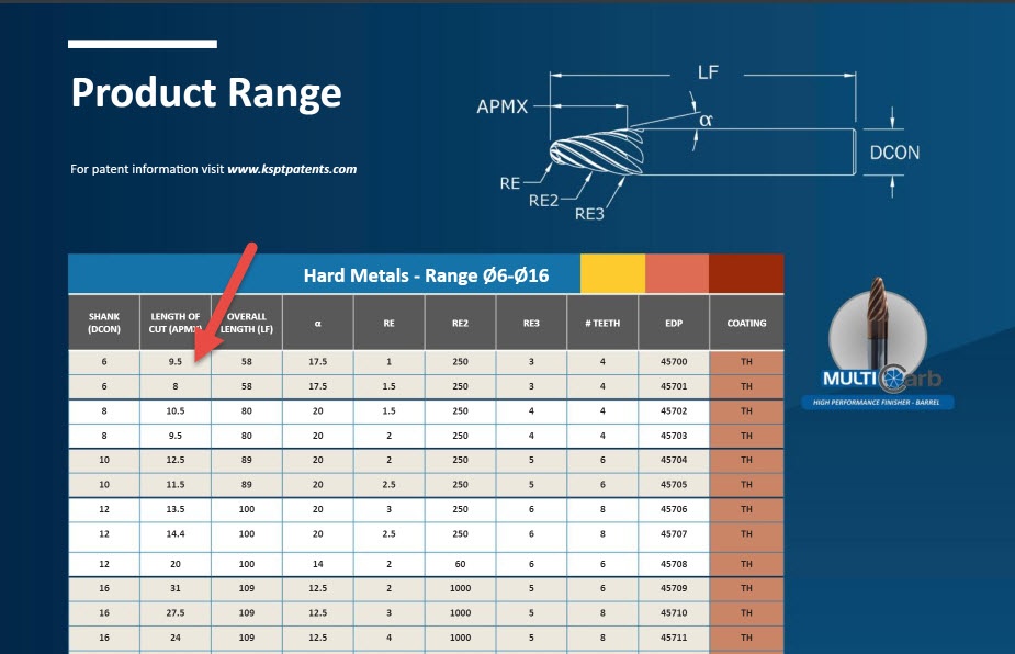

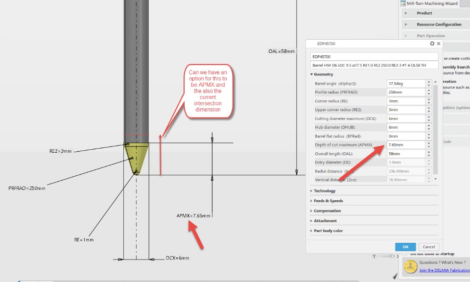

​​​​​​​Would it be possible to create an extra geometry dimension when designing a barrel tool? Kyocera-SGS extend the flute cutting length past the radius intersection point on the shank of the rod. So If you try and Z machine from the base up the surface you will see collisions in some cases if this flute cut length isn't correct.
