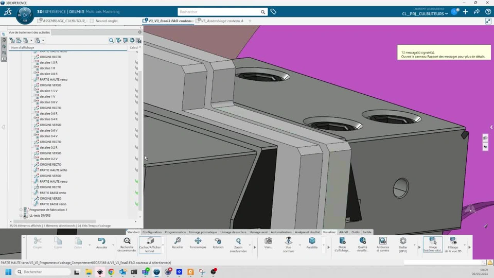

I want to share with you another educational project. We have a student who wanted to make survival knives !! The shape is very particular and we decided to mill them with the flank. After a lot of try i decided to use the "ISOPARAMETRIC milling" with a cylindrical cutter (we modeled a barrel one with a large radius)...So you can see the CAM and the result in pictures and videos belows (only finishing).

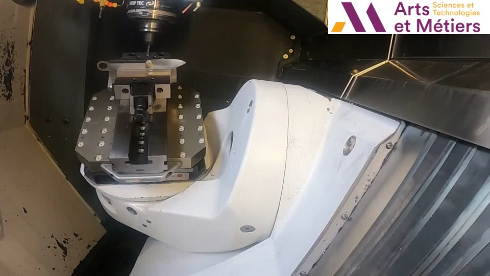

Milling : without cooling to see the teajectories :

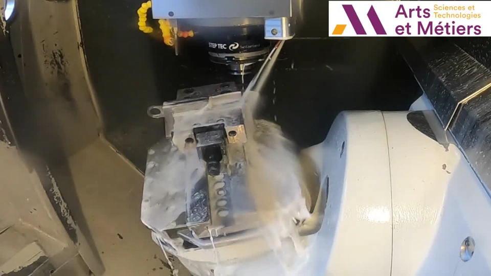

Milling : with cooling :

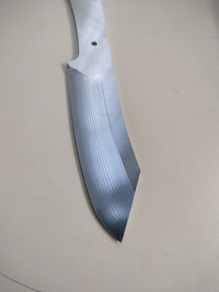

The final  knife :
