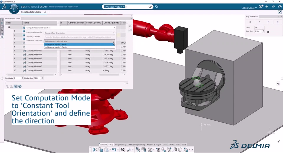

In the recent FD01 update, constant tool orientation for rotary tables was implemented for robots in the material deposition programmer.

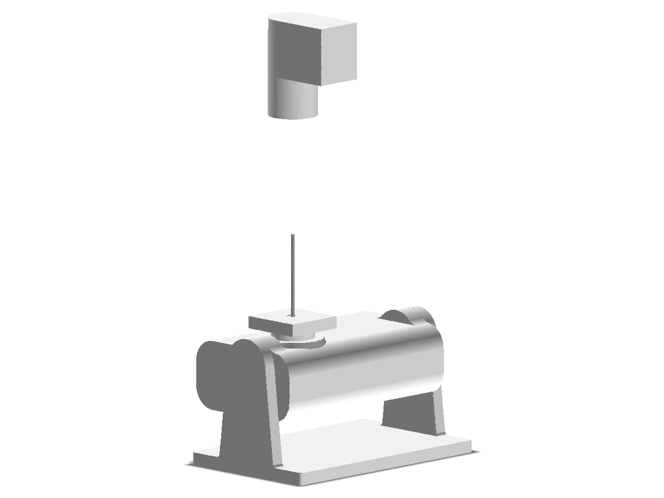

Is it possible to use this methodology on a 5-axis CNC where one of the machine's axis is a rotary table?
I managed to do something similar with a 5-axis machine, but I don't know if it's the best methodology. I added the 3DXML file.
