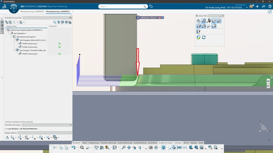

Hello Community,
I need advice on 2D machining in Shop Floor Programer. How do I machine a 2D contour at an angle of 15 degrees? I need to use a toroidal tool with an R2 radius. The toolpath is calculated as if the tool were cylindrical. How do I adjust the tool to make contact with the surface? Other CAM systems do this automatically.
Thank you for your advice.
