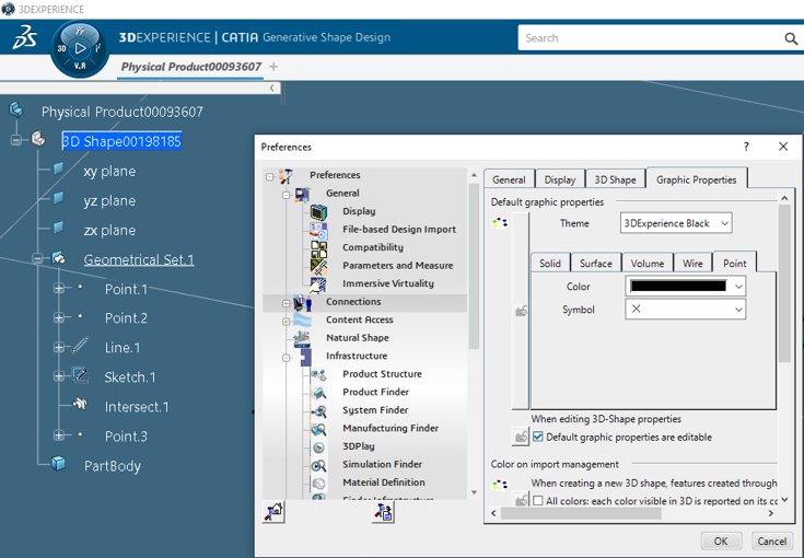

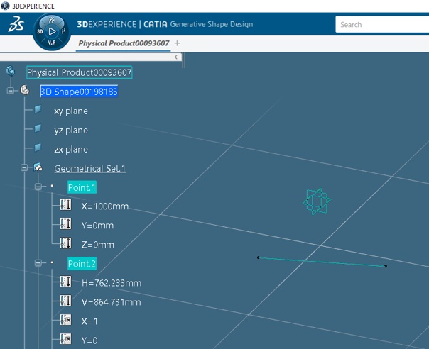

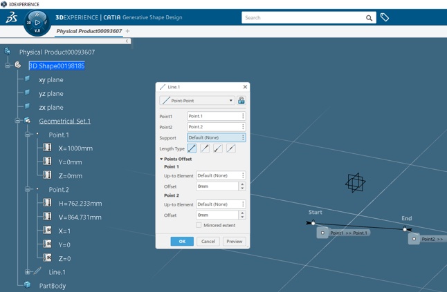

I'm having an issue post the hotfixes where points are no longer visible whatsoever. I've experimented with feature driven geometry, formula driven via GSD and CGM functions as well as datum however no visual of any such point generated.

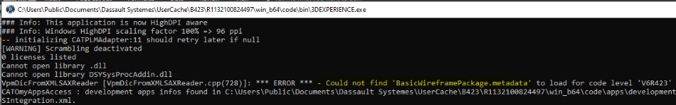

I have explored both legacy and V6 preferences thoroughly many times over and even done a preferences reset to factory to resolve this issue with no luck, all GPU drivers are up to date & cards are certified. The only hint at an error so far is in the session executable which shows package missing errors for wireframe, yet all other wireframe elements are working normally..
