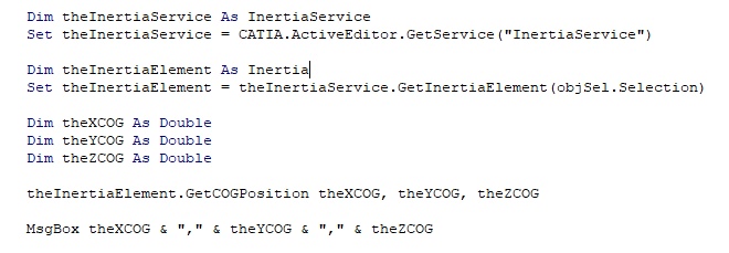

I am trying to write a VBA script for V6 to export the CofG co-ordinates of the selected part/product to a text file.
I've found a the below code in the DSYAutomation.chm but it returns 0,0,0 instead of the CofG of the part.
Does anyone have a script to achieve this that they could share?
