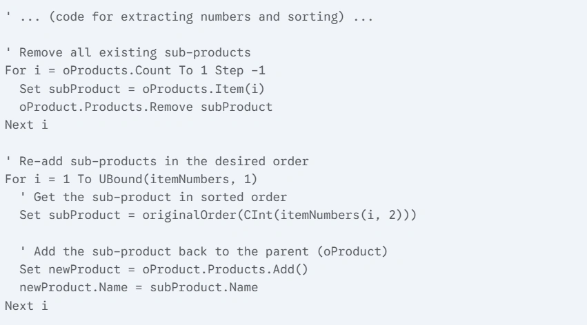

Hello, I am working with a VBA script in CATIA to rearrange the order of sub-products within an assembly. I'm using oProduct.Products.Add() to create new sub-products and add them to the parent product, but this approach is not working as expected.
Specifically:
- I'm extracting numbers from the Part Numbers of the sub-products to determine the desired order.
- I'm removing all existing sub-products from the parent product.
- I'm then trying to create new sub-products and add them back to the parent product in the desired order using oProduct.Products.Add().
However, this oProduct.Products.Add() operation does not seem to be creating the sub-products as intended.
I would like to:
- Understand why oProduct.Products.Add() is not working in my case.
Find an alternative method to effectively add the sub-products to the parent product in the desired order.
