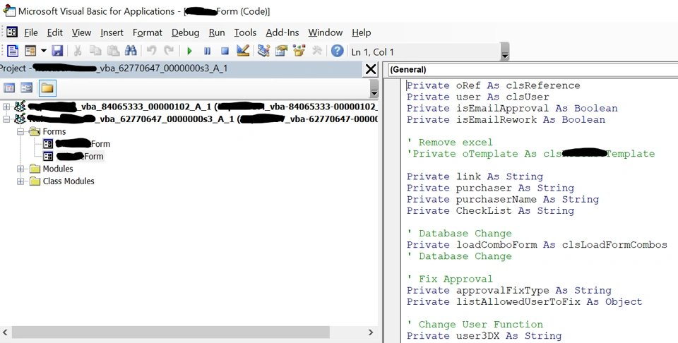

  • We are using VBA Macros with forms in our system as shown below. For 90% of the users, everything works fine, and we haven't done any changes for a long while. For some reason though, it fails on some users with the following error messages. Everyone is using the same "Released" macro.
  • Cleaning the cache / CATSettings, PC restarts don't solve it
  • Re-installing the 3DX sometimes solves it.
  • It happens in variety of PC hardware, and both in Win10 and Win11.
  • Our platform is R2024x FD04.
  • It stops working suddenly.

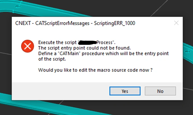

CNext - CATScriptErrorMessages - ScriptingERR_1000
Compile error in hidden module
Installed apps
Any suggestions on how to fix it? Thanks a lot!
