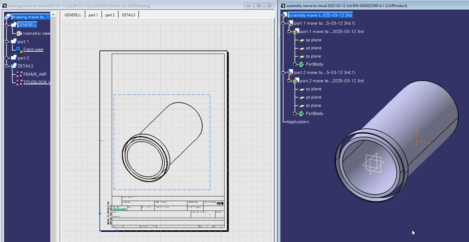

the topic of this question is the batch routine “CAD Transition” in release R2023x
the transition enables powerby data to be converted to CATIA 3DX data as a new revision
assemblies with their components are converted perfectly, but unfortunately the corresponding assembly drawing is not.

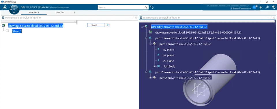

Drawing is created as a new revision, but without content, neither views nor sheets are converted.
does anyone know about this problem, or does anyone know a solution therefore ?
note:
both, the assembly and the drawing are converted correctly on cloud without any issue
CATIA V5 assembly and drawing
Result after conversiion using batch routine "CAD Transition"
