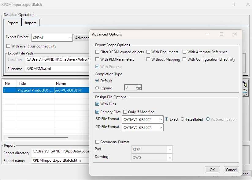

3. To the product structure created in step 2, also add a 3DShape and create a simple design in V6.
4. Save the structure and export the structure using XPDMImportExportBatch using options as shown
 Expected : The structure should be exported into XPDM XML file and should also export the CATPart files for the leaf level parts. Actual :  XPDML is exported for the complete structure but the CAD files are only exported for V6 data.
