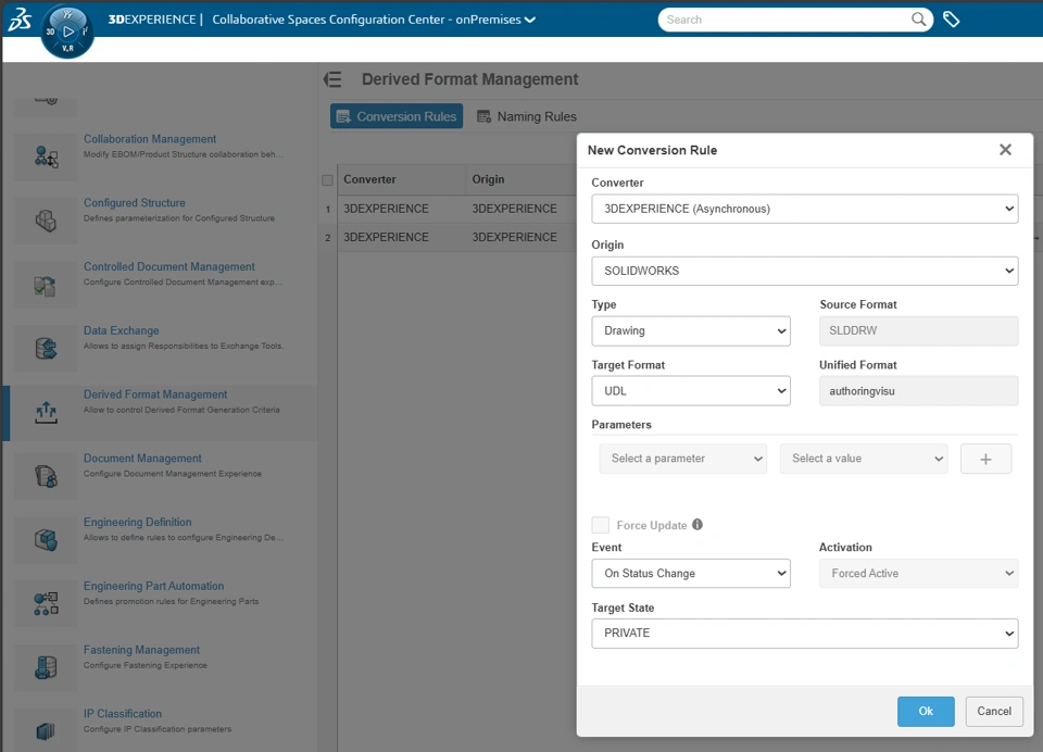

We are looking for a mechanism to update the UDL format for 3DX Drawings (CAD Master = 3DEXPERIENCE).
Why?
in CATIA 3DX Drawings, we are using the Attribute Link functionality in the Titleblock to push attributes values. (e.g. Checked By, Status, CheckedOn) and all the time, the UDL is not updated because the Drawing, after maturity changed, was never opened in the Client and Saved for the UDL to be recomputed and stored in DB.
We've noticed that the UDL update action in DFC is available for UPS SolidWorks Drawings.
Do you know if R&D will bring this functionality also for 3DX Drawings in the future?
Solidworks UPS Drawing....
3DX Drawing - UDL format is missing.
