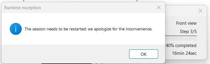

While I’ve managed to optimize the 3D performance within the Assembly Design workbench, I hit a wall when moving to Drafting. Generating the initial or isometric views takes several hours or simply freezes CATIA entirely, typically getting stuck at step 3/5 of the view generation process. During a tested, I maintain the execution by 03:00:00, then I close the CATIA application.

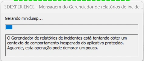

During the creating a view in the sub-assembly 41 appear these error messages:
Translate this image:
3DEXPERIENCE - Incident Report Manager Message...
Generating minidump...
The Incident Report Manager is trying to get a context of unexpected behavior of the protected application. Please wait, this operation may take a while.
However, after performing this cleanup, I attempted to detail the main assembly once again, but the process failed/froze just as before.

Unfortunately, in all scenarios, the result remained the same: CATIA freezes at step 3/5.
