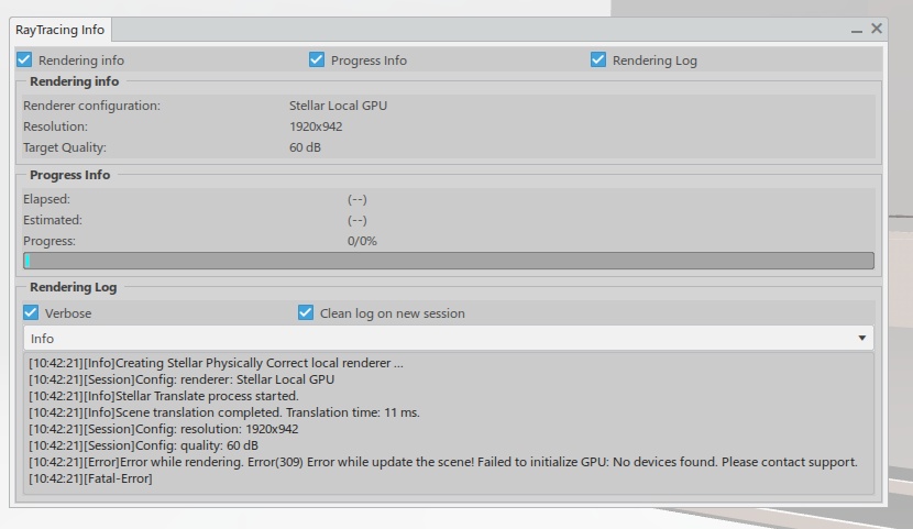

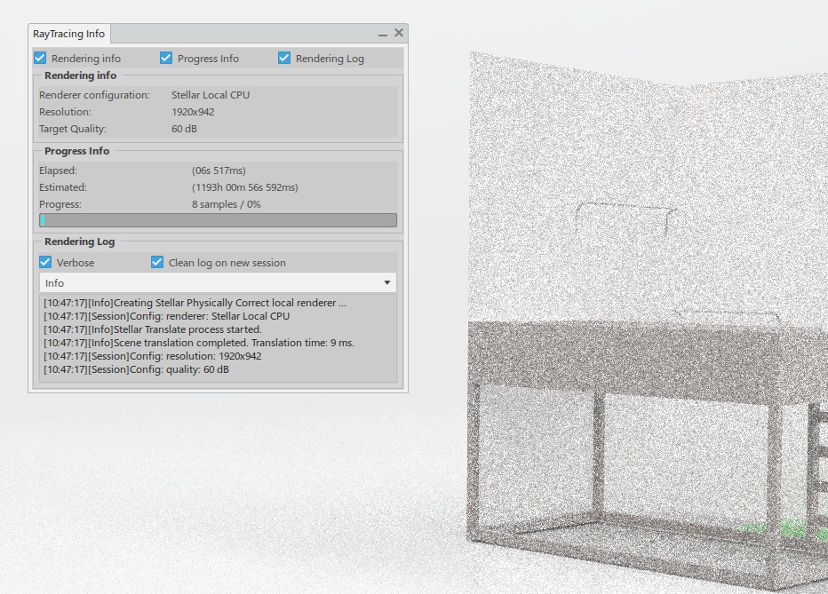

I am not able to use the Stellar GPU raytracing feature on CATIA Live Rendering. I'm running on a laptop with a Ryzen 7 8 core and an NVIDIA 3060 laptop GPU. The raytracer works when its in CPU mode, but it's incredibly slow. It refuses to run when in GPU mode (I'm attaching the logs).
Is this because the GPU is unvalidated hardware (i.e. not a Quadro); and, if so, can I do anything about it?
