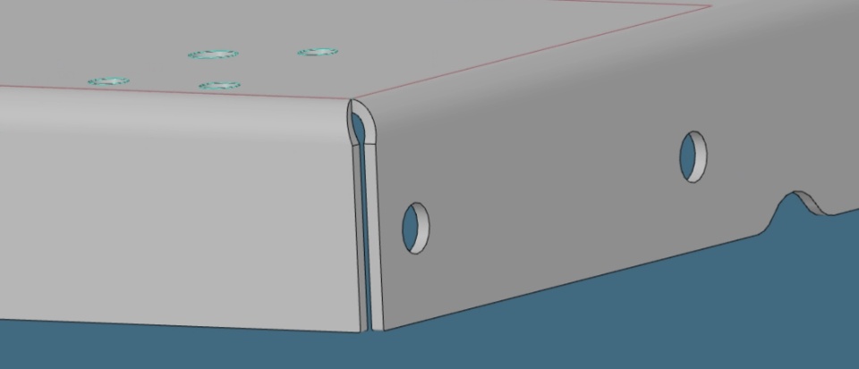

In SolidWorks you could close a corner on sheet metal components using the weld corner command. Does Catia 3DX sheet metal designer has something like that? or how can I close the corner easy? I used to close the corners to run FEA and setup the part as a Solid.
