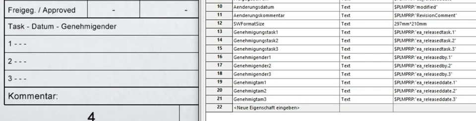

Hi all,
how is it possible to mapp the Route Information into the Tittle Block in CATIA 3DEXPERIENCE in public Cloud.
In SOLIDWORKS it is possible to mapp the Tittle of a Route Task, Date of the approval and User name who has approved this tas.(Max. 3Task)
I hope this is also possible in CATIA?
All of our customers must have this Information on the Drawing. (created name date, checked name date , released name date)
I hope we have already a solution for this?
Here the mapping from SOLIDWORKS:
