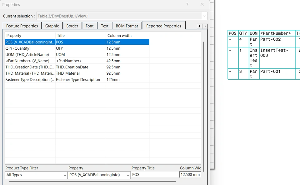

I've implemented find number (DS Documentation: 3DEXPERIENCE > Enterprise Knowledge Language > Server Types and Functions > EKL Functions by Modeler > CAD Extension Method Functions).
Instance title value will be transfered to CAD Extention Find Number (V_XCADBallooningInfo) and is be used in ballooning as position number and user defined counter in bill of material.
Our Challange:
If this property is used with ootb title "Find Numbwer" it works as expected.
In case of modifing the property title to e.g. "POS" or others, the valuies in this column will be not displayed, only as "-"
Are there any settings to be changed, that I can modify the property title without loosing the values?
I need a permanent solution, because the BoM style is customized, and instanciated. I can't rename the cell in BoM table manual each time (thats the current workaround)
for other attribute properties like quantity or custom attributes, it works as expected without this issue.
