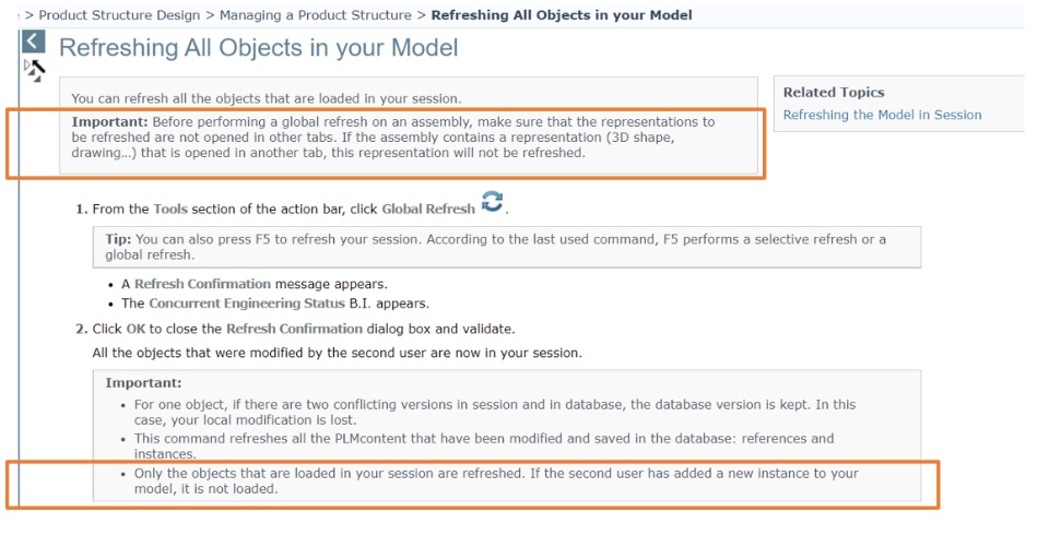

In Help there is explanation of the mechanism but not the desired value for concurrent engineering teams that 3DEXPERIENCE should represent
